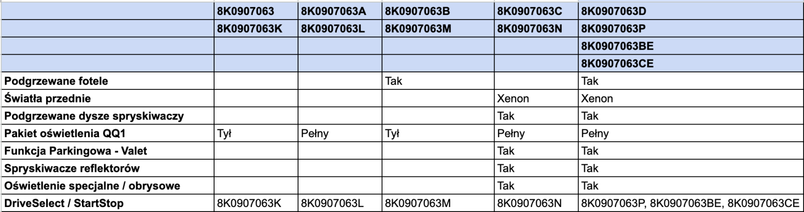

Przedlift
8K0907063, 8K0907063A, 8K0907063B, 8K0907063C, 8K0907063D, 8K0907063E,  8K0907063F,  8K0907063G, 8K0907063H, 8K0907063J, 8K0907063K, 8K0907063L, 8K0907063M, 8K0907063N, 8K0907063P, 8K0907063BE, 8K0907063CE

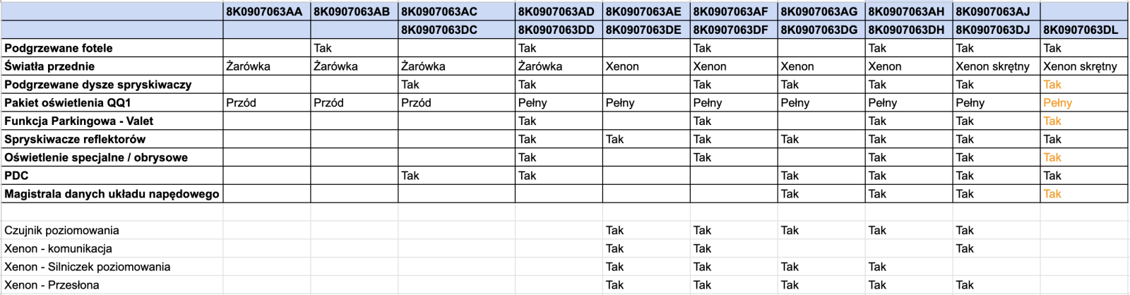

Polift:
8K0907063AA, 8K0907063AB, 8K0907063AC, 8K0907063AD, 8K0907063AE, 8K0907063AG, 8K0907063AH, 8K0907063AJ, 8K0907063AL
8K0907063DC, 8K0907063DD, 8K0907063DE, 8K0907063DG, 8K0907063DH, 8K0907063DJ, 8K0907063DL

W załącznikach wrzucam tabele funkcjonalności.
