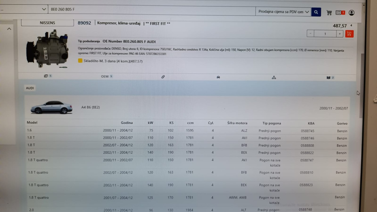

OEM Audi shop and service says this is a part number B6 engine cod ALT
8E0 260 805 F
also comfirmed one more time with a friend who works in shop with aftermarket parts
