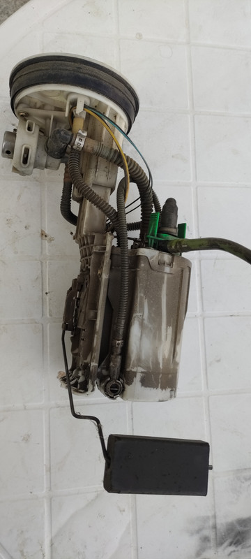

Ok , thank you for you answers and knowledge . So i have this from my b6 2003 year donor  , so i just  replace my   it for my fuel  senior / pump ect and it should work if i understand it correctly  ,  i just take out mine and install this  who'll unit from the picture
This is a vin of the doonor car .

This one will work correctly. If not, switch two wires from the level sensor, but i doubt it would be necessary.

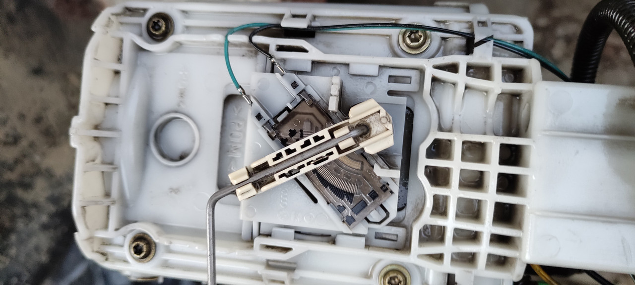

Try to switch these two wires, that go out from the sensor and look on the cluster.
Switch it how , what do you mean ,   take a wires from a 2003 and put in on 2001  sensor/pump unit , or just switch wires places on old sensor/pump unit '
Switch the wires on the sensor (green and black) with places. Connect it to the car and without putting it back together check if it worked.
