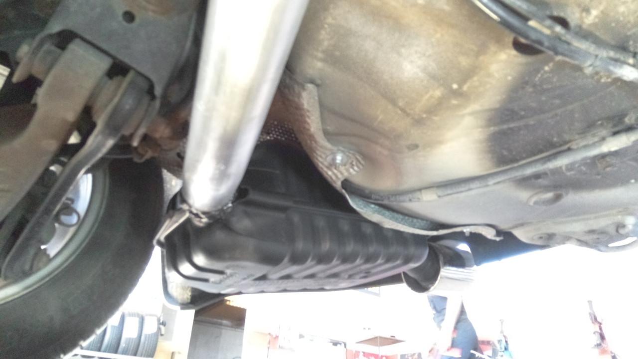

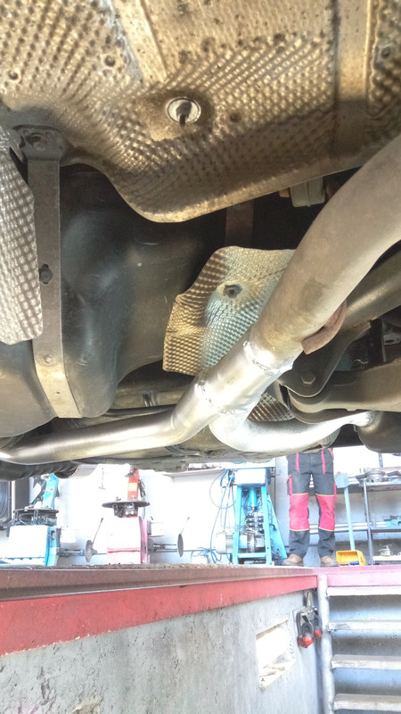

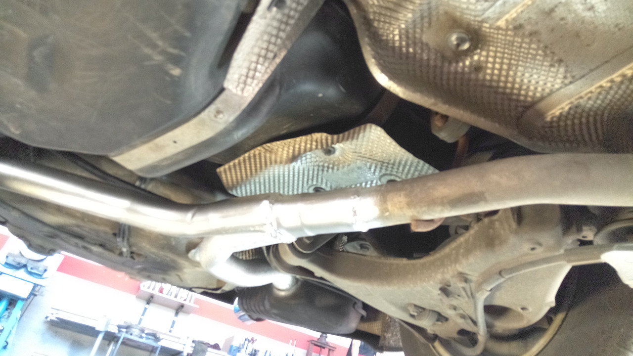

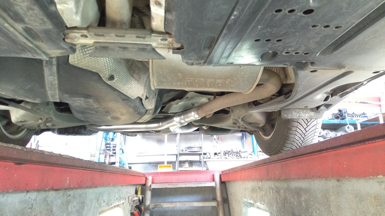

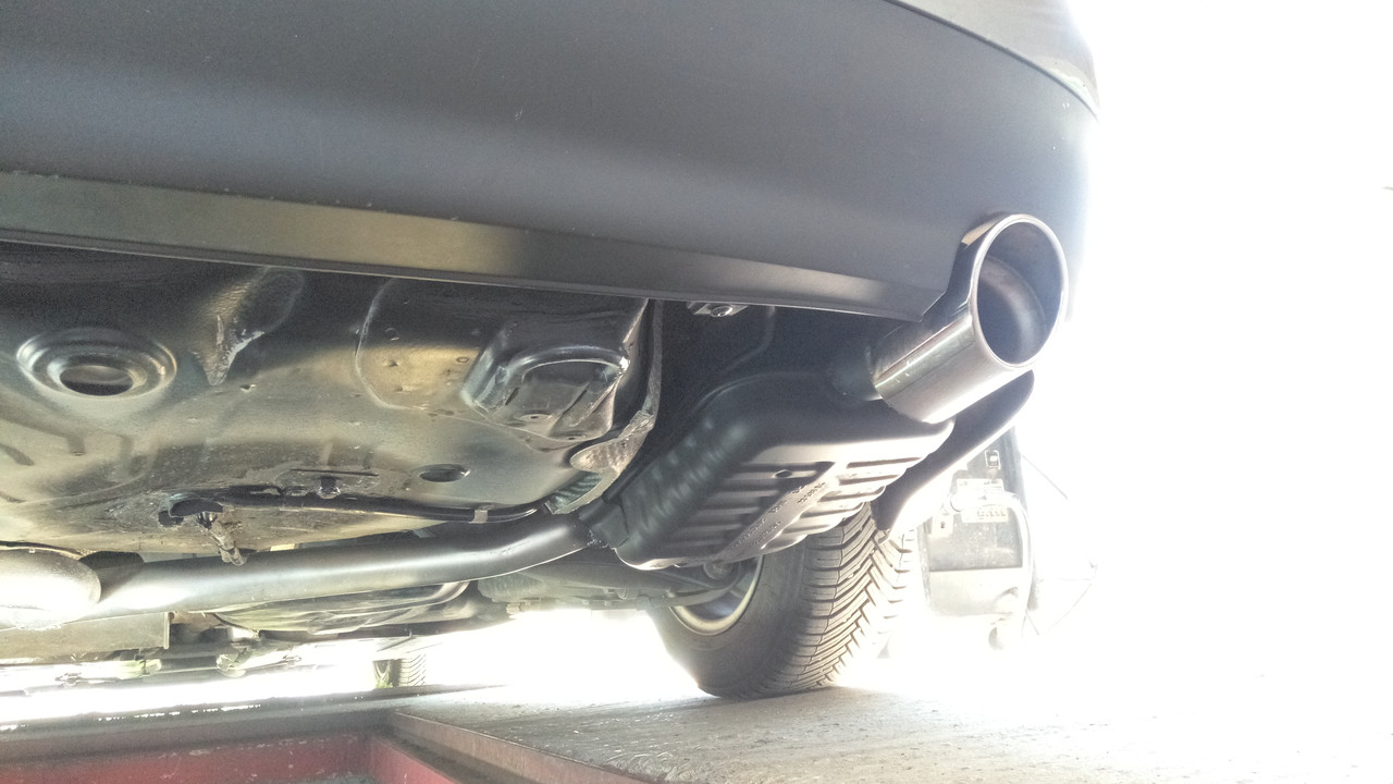

You need one exhoust muffler (better OEM  if you need it make a road leagal like in Croatia ) , muffler carrier , heat protection ,  somting like aluminium bolts for heat protection 5 pices  , buy it new OEM  , then 1.8 t or s4 b6 lower part of rear bumper.
Heat protection can be for anything in Audi , it is flexible.
100 mm rear extension for muffler .
A pay second hand muffler +  lower part for bummper  1.8 t  a 70 euros
And of course ad a new pipe in exhoust shop .

I don't have but sound nice, nothing too much but you get a good sound, nothing exaggerated, but you get a beautiful rear end for a little money , let say  200 euros for everything , instalation ,  parts ect.
