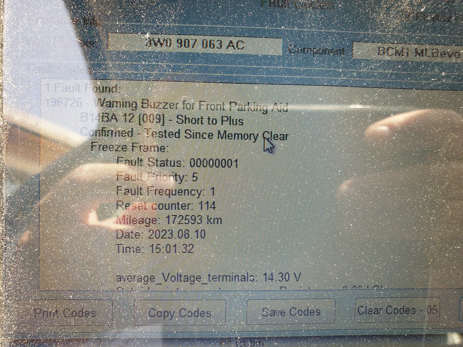

Yes
I have an error on front buzzer.
Short to plus on front buzzer i check wiring cable it is ok.
At beginig buzzer makes sound but after that in 5 second i get this error.
Other problem is that menu park aid is not available in MMI.
And mmi not display pdc image only camera
Post complete Auto-Scan here.

196726 - Warning Buzzer for Front Parking Aid
Yes but why is this error on buzzer ? I already check byte 38 no efect! Any idea?
Either the speaker is defective or the wiring is defective.
