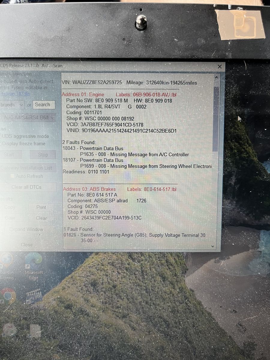

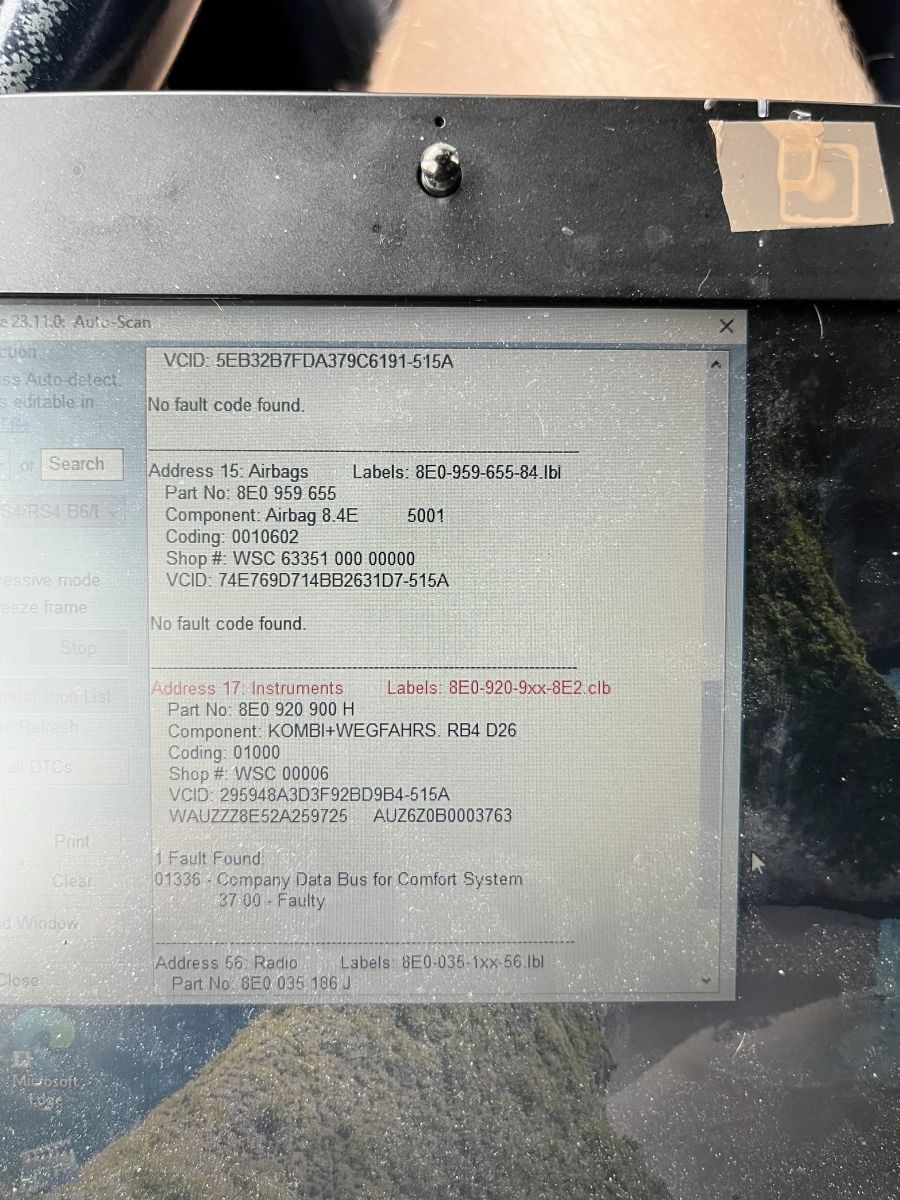

Najpierw to pokazał chyba wszystkie błędy które się da, po skasowaniu ich pokazały się tylko te  to co są  na zdjęciu

Address 01: Engine        Labels: 06B-906-018-AVJ.lbl
   Part No SW: 8E0 909 518 M    HW: 8E0 909 018
   Component: 1.8L R4/5VT     G   0002
   Coding: 0011701
   Shop #: WSC 00000 000 08192
   VCID: 3A7B87EF765F9041CD-515A
   VINID: 9D196AAAA2151424421491C214C52BE6D1
2 Faults Found:
18043 - Powertrain Data Bus
            P1635 - 008 - Missing Message from A/C Controller
18107 - Powertrain Data Bus
            P1699 - 008 - Missing Message from Steering Wheel Electronics
Readiness: 0110 1101
Address 03: ABS Brakes        Labels: 8E0-614-517.lbl
   Part No: 8E0 614 517 A
   Component: ABS/ESP allrad      1726
   Coding: 04275
   Shop #: WSC 00000
   VCID: 2643439FC2E704A199-513C
1 Fault Found:
01826 - Sensor for Steering Angle (G85); Supply Voltage Terminal 30
            35-00 - -
Address 08: Auto HVAC        Labels: 8E0-820-043.lbl
   Part No: 8E0 820 043
   Component:   A4 Klimaautomat   1012
   Coding: 00000
   Shop #: WSC 63351
   VCID: 5EB32B7FDA379C6191-515A
6 Faults Found:
01317 - Control Module in Instrument Cluster (J285)
            49-00 - No Communications
01330 - Central Control Module for Central Convenience (J393)
00466 - Control Module for Steering Column Electronics (J527)
00457 - Central Electronics Control Module / BCM (J519)
00474 - Control Module for Immobilizer
            27-10 - Implausible Signal - Intermittent
Address 15: Airbags        Labels: 8E0-959-655-84.lbl
   Part No: 8E0 959 655
   Component: Airbag 8.4E         5001
   Coding: 0010602
   Shop #: WSC 63351 000 00000
   VCID: 74E769D714BB2631D7-515A
No fault code found.
Address 17: Instruments        Labels: 8E0-920-9xx-8E2.clb
   Part No: 8E0 920 900 H
   Component: KOMBI+WEGFAHRS. RB4 D26
   Coding: 01000
   Shop #: WSC 00006
   VCID: 295948A3D3F92BD9B4-5178
   WAUZZZ8E52A259725     AUZ6Z0B0003763
9 Faults Found:
01331 - Door Control Module; Driver Side (J386)
01332 - Door Control Module; Passenger Side (J387)
01334 - Door Control Module; Rear Right (J389)
01333 - Door Control Module; Rear Left (J388)
01320 - Control Module for Climatronic (J255)
01336 - Company Data Bus for Comfort System
            37-10 - Faulty - Intermittent
End-------------------------(Elapsed Time: 06:19)---------------
