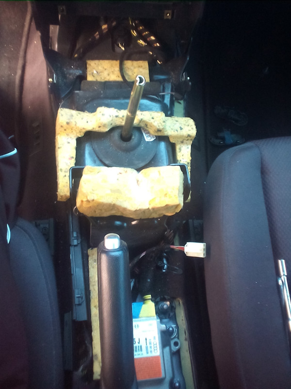

I crashed my car   ,  front airbags deployed  , changed set belts , and  second half airbags and that's was it for me  ,  some say so i dont know is it true but think it is  , if  tree time crashed ,  you must change this
WWW.EBAY.CO.UK
Find many great new & used options and get the best deals for Audi+A4+Airbag+ECU+Module+8e0+959+655+J at the best online prices at eBay! Free delivery for many products!
 next to  hand brake when you remove console
Someone said   this wire from must be changed after crash but i didn't and everything is fine  .maye this help you maybe not.
