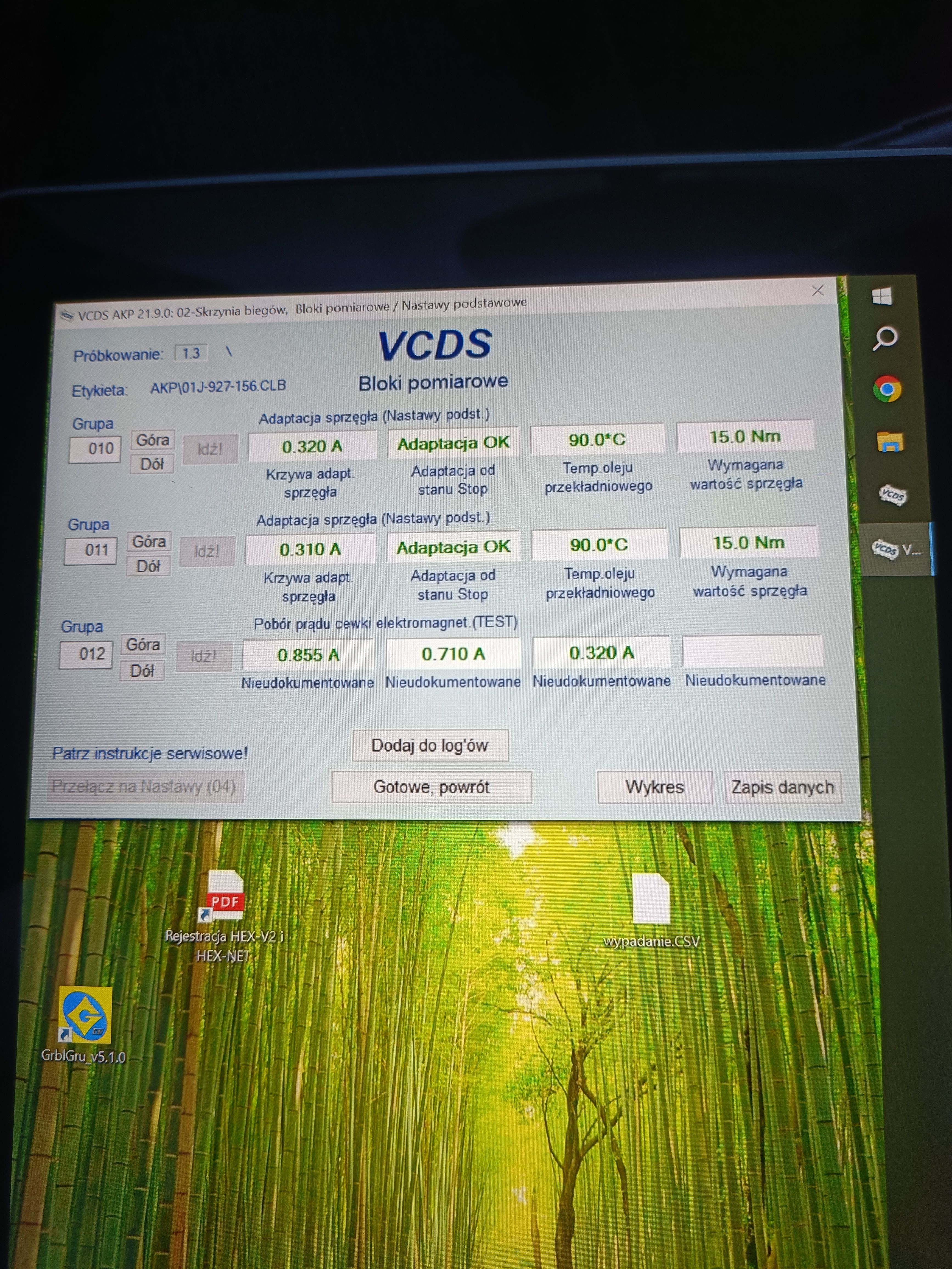

Dodałem jeszcze bloki pomiarowe ale raczej bloki są OK @Bart-S Lukniesz może i coś doradzisz?

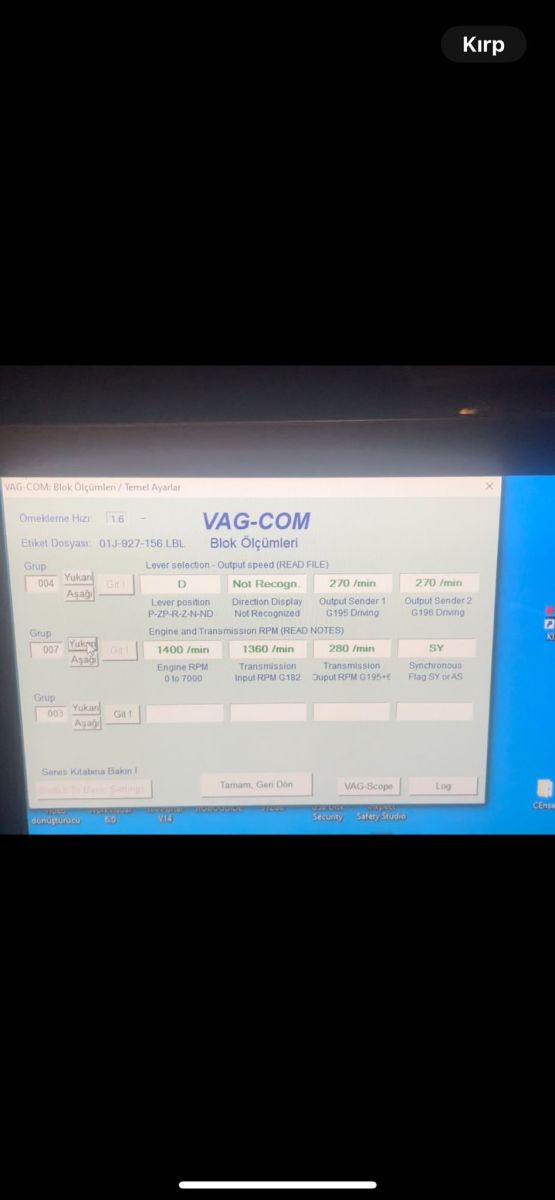

I'm writing to you from Turkey. I'm using translation, please excuse me. I have a 2004 Audi A4 B6 with a 1.9TDI AVF engine code. My transmission is 01J.

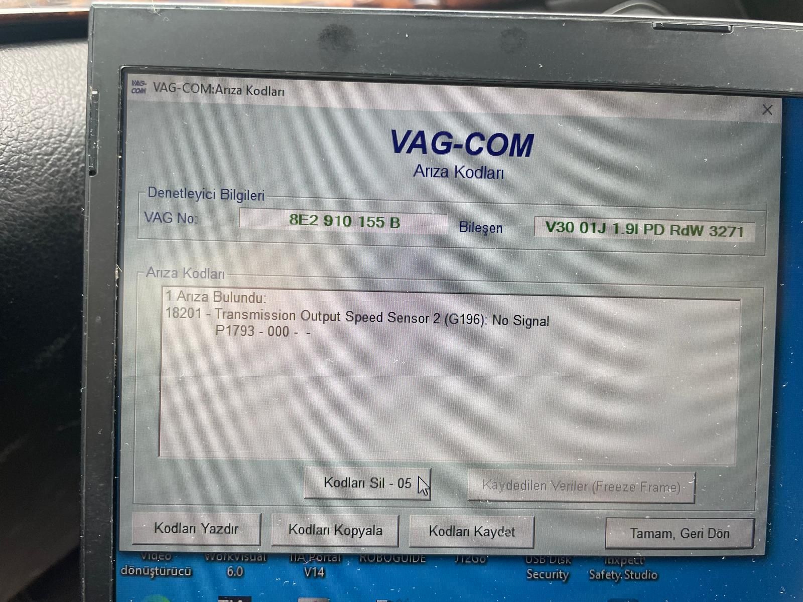

I've been having a problem with my transmission lately. I found you through my research. My problem is 18201 P1793 output sensor 2 no signal.

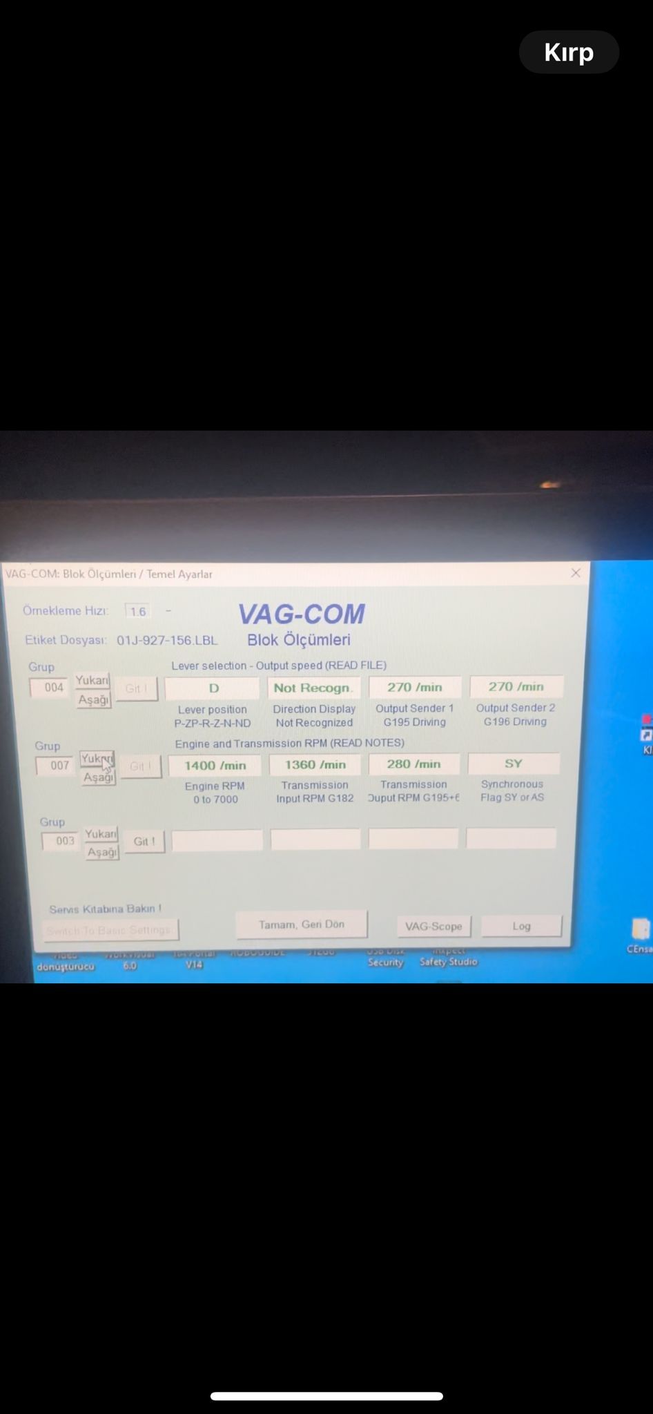

I'm having trouble shifting forward. The car screams but doesn't shift. Or it's difficult to shift. It shifts when I release the accelerator and press it again. I have a VCDS device. The scan showed error 18201. However, I saw that sensor 1 and sensor 2 are synchronized in the measurement blocks. So, I assumed the sensor was working. I think there's a problem with the solder traces on the TCM. It's generally worse when the engine is cold and better when it's warm. I have a similar problem and would like to consult you. Bart-S is an expert in this area.
I need your help. I can't find an expert in Turkey. We can contact you via WhatsApp or Telegram. I'm in a difficult situation.
Thank you, have a good day.
Edytowane przez samet_s90
Hi,
It clearly looks as a problem with TCU unit. Below my each post (footer) you can find phone and e-mail for direct contact.
Bardzo dziękuję za szybki powrót. Czy mówimy o module TCM? Czyli, jak podejrzewałem, aluminiowe luty mogły się poluzować? Czy użytkowanie pojazdu w tym stanie może powodować jakieś problemy?
Thank you very much for your early return. Are we talking about the TCM unit? So, as I suspected, the aluminum solders may have come loose? Will using the vehicle in this condition cause any problems?
TCM and TCU means the same :) Further drive is possible depend on which type of error you will find at TCU error buffer. At your case it's G196 so I won't identify it as a huge issue.
