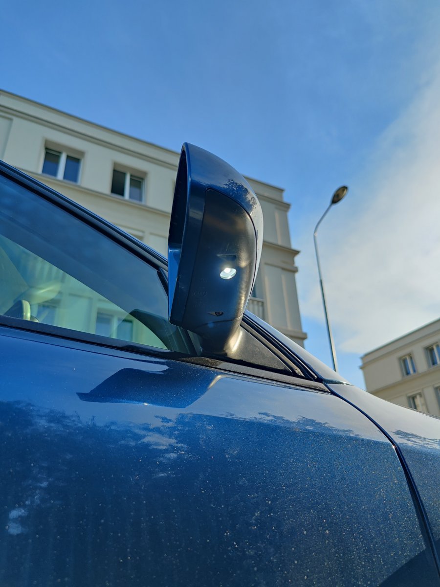

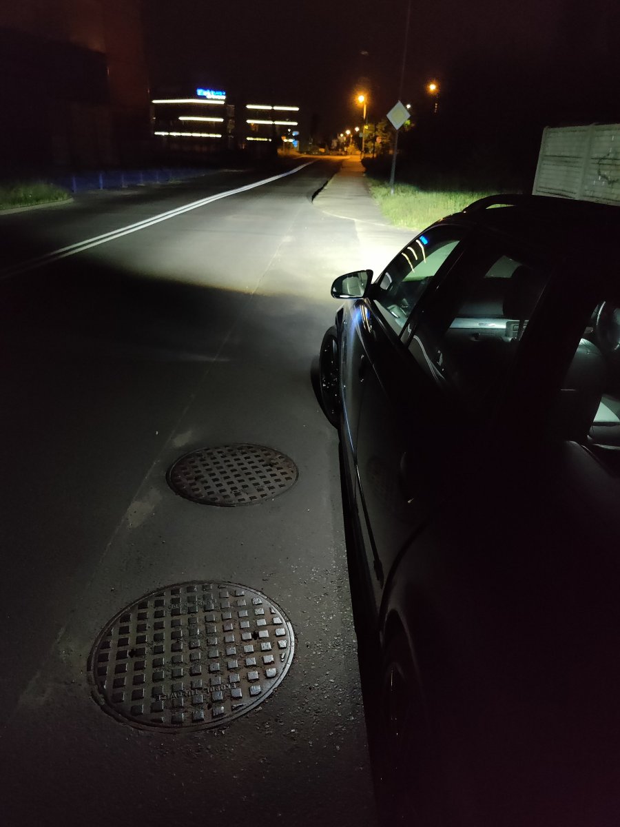

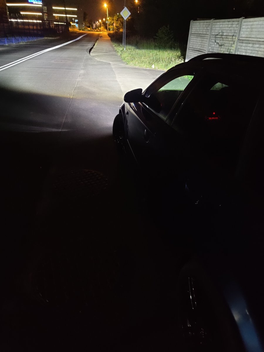

Wydaje mi się, że efekt przyjemny, nie jest to światło powalające jak mijania ? coś jednak doświetla
Podoba mi się, że działa płynnie przy gaszeniu, podczas otwierania/zamykania centralnego, wyciągnięcie kluczyka oraz otwarcie którychkolwiek drzwi.
Pewno pedanci by dopracowali, żeby tylne drzwi nie miały wpływu czy też ogarnięcie jakoś czujnika zmierzchu. Raczej dołożę po prostu drugie i tyle.
Chyba jakoś też zamaskuje od góry diodę bo między szkłem a obudową przebija się światło.

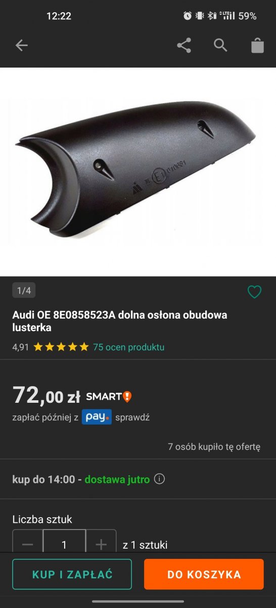

Very nice update , what is the part number of this lover mirror covers.
Screenshot_2023-06-28-12-22-51-73_a038fdda0361bc57fee075193df50ddc.thumb.jpg.ad695c173a0f369307b04a3ba6b44f19.jpg

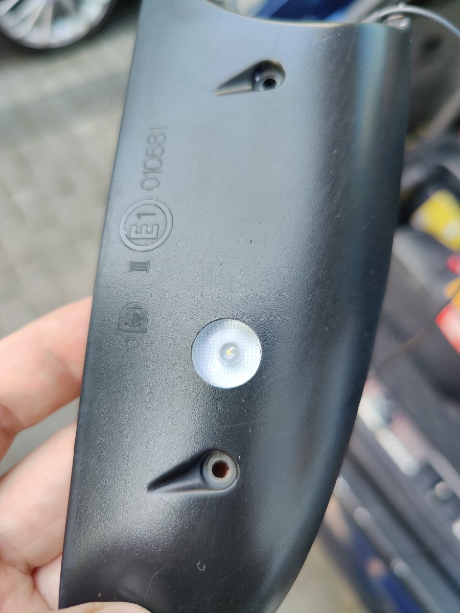

Aha, you added your self LED light, I tout its OEM.
Exactly, I drilled a hole and glue LED, two wires inside car and it works.
I know, somebody bought this cover from A6 C6 because probably there were those lights.
In my opinion 160 PLN it's too much ?
My cost is about 5 PLN and about 5 hours of work.
I'm satisfied of this.
Edytowane przez Ivanek
When you do it your self it's so more satisfying , i did find this i thought it was original  , so this is is also DiY , maybe you should do a little diy , what led , what dril for the plastic , ect.
Dos it light all the way or it shout of when you drive .

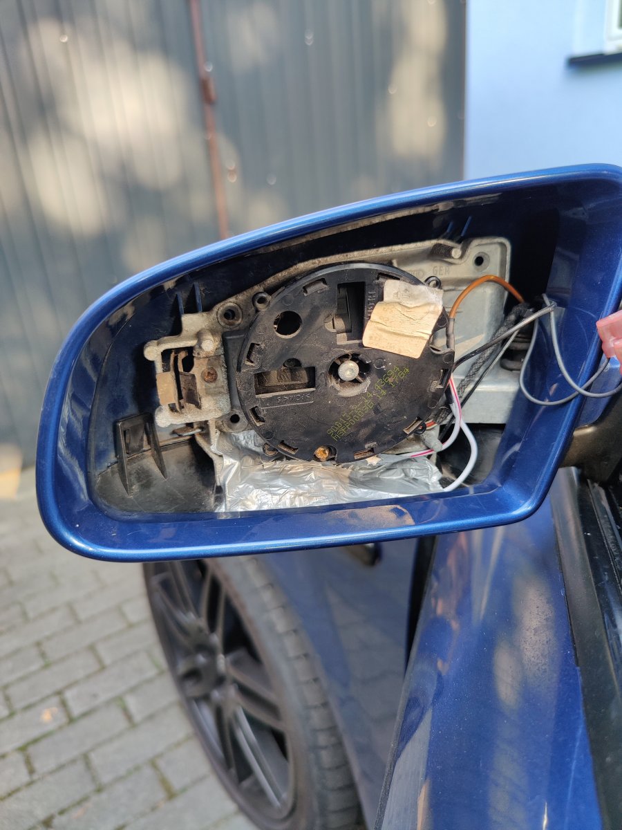

They aren't working when driving.
It's simple, when lock and unlock the car and also when open doors, it doesn't matter which.
Nice , can you send me on private message , what led to buy and how to connect it to work like you describe , with what did you drill plastic  if that  isent  a problem, thank you.
Edytowane przez MarioR34
Poprawiłem mocowanie, przykręcona na cztery śruby.
This look's similiar to mine.
Mountage is simple.
Of course you have to connect two wires to LED, +12V and 0V. Those two wires you have to put inside car, as you can see I've used rubber under OEM door electric socket.
You have to go to left side of car, close to foot rest, under those plastic there is a orange socket.
I checked this with multimeter where I have +12V after unlocking car.
17th pin is for +12V, 2nd pin is for signal.
From both mirrors connect this togheter in same place.
That's all.
Most difficult part is to carefully demount the mirrors' cover, also I had to unscrew all the way mirror from door to put wires inside the doors. After this work should go fast and quite simple. Check out my photos ;)
